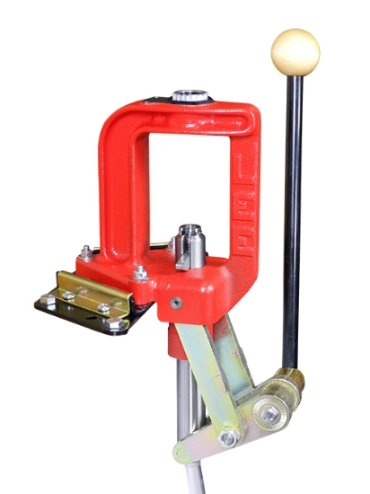

The Lee Classic Cast accepts 1&1/4-12 dies.
Yes, I was trying to find a way around buying another press. Thanks for your reply but I just bought an RCBS Rock Chucker Supreme new on Amazon for the same price as the cheapest used one on Ebay. It was actually cheaper than the Lee as well.
