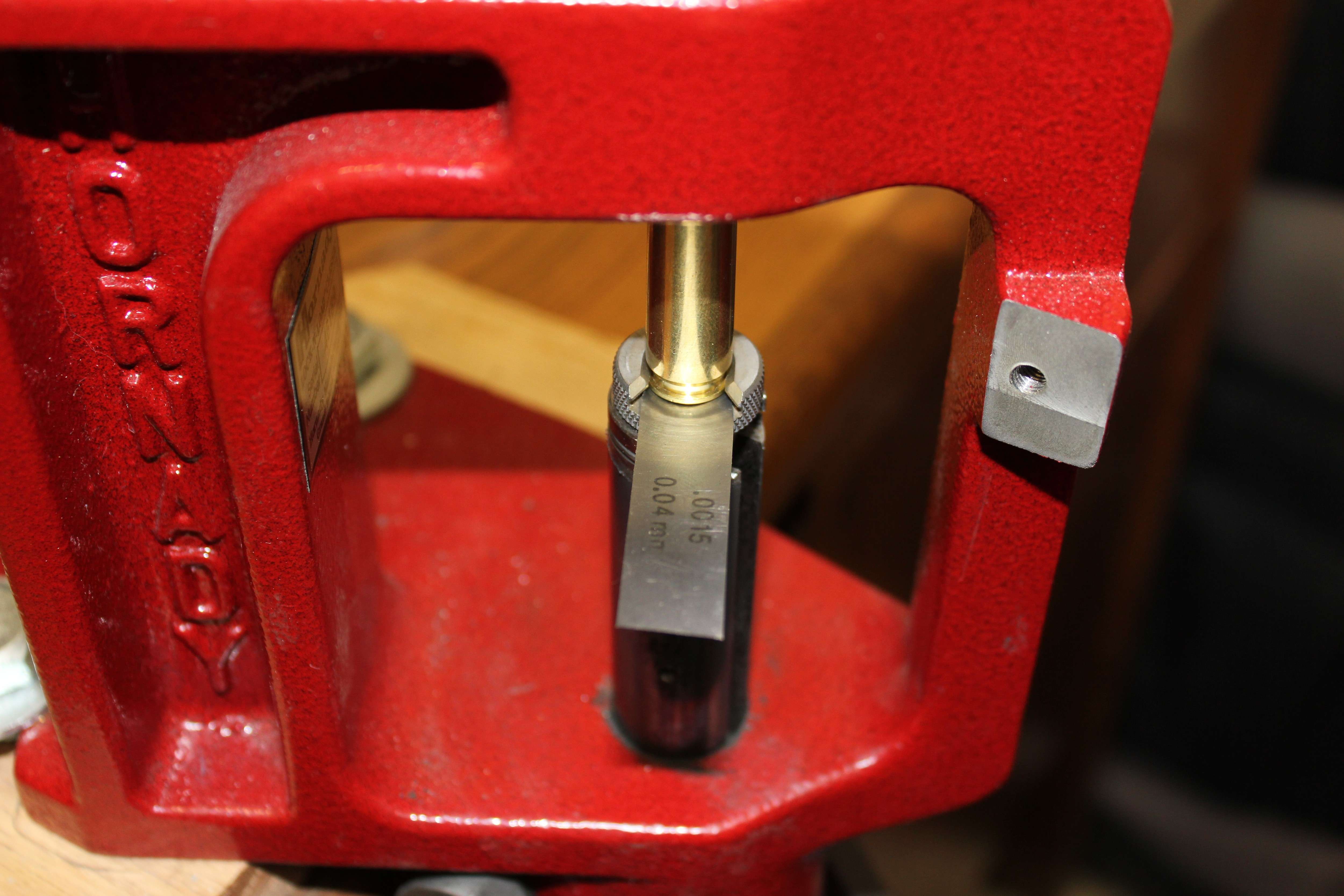

As stated earlier you can place the appropriate sized feeler gauge under the case to get it to go a little deeper into the die

Thanks for the thoughts. I have 8-10 shell holders for that sized cartridge that I’ve collected over the years. Shaving one down seemed a better idea than altering my Whidden bushing die. Adding another step in the process (pushing a feeler gage under every piece of brass) seemed more time consuming than I liked.
