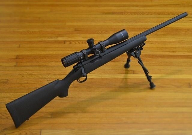

Lucked into a Gradous accurized R700 LTR (factory barrel) in .308 Win. Hasn't arrived yet, but I'm optimistic.

I know it's a factory gun, but I'm still all about the accuracy. Be interesting to see what I can squeeze out of it, especially considering the 20" HB, & 12" twist...
