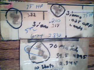

Ive used 70MKs & 75 Sierra HPs as well as 75gr Hornady HPs with 39.5grs H4895 with very good results in my Rem 700, 24" factory barrel. Here's some nicer groups Ive shot with them.
here's a group @200yds with the 70MK.
Last hear I started working on the Hornady 105HPBT and got this two 5 shot groups or one 10 shot group, throw out the flyers and the 8 shots go 2 3/8" @300yds. This is with 4000MR powder.
