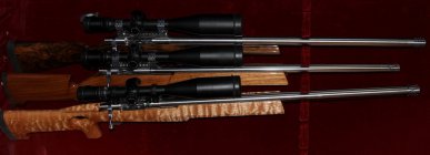

As I have stated previously,,, "I hate recoil"..
On my 30-338 (top gun in pic)I have a Pachmayer recoil pad, a Graco mercury recoil reducer, AND,,, a Vais muzzle brake. The beast has been tamed!!
my 6SLR (middle gun in pic) has a Pachmayer pad, Graco reducer, and a Harrell's brake.
My 300WSM (bottom gun in pic) has a Pachmayer pad, Edwards MAX reducer, and Harrell's brake.
The components seem to work in harmony together and my old body loves the results.
