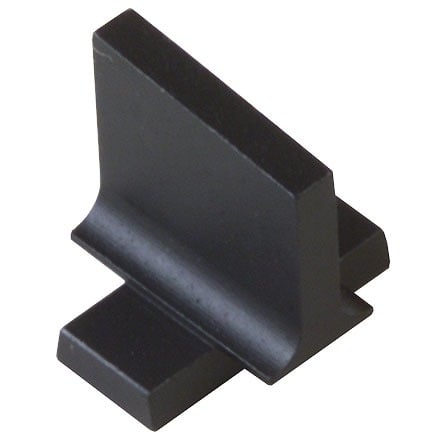

Do you still have the front sight band? Then just get this
I agree. The problem is Mc Gowan won't do any front barrel work. So is that front sight a band that slips on a turned down shank and is silver soldered? I'd like to keep the original look but is just a pleasurable shooter.
Carl Gustaf's 1905-elit diopter sight, and the rear sight that goes with it. If you are going to the trouble of matching barrel contours get the sights that the Swede's used and have the best.
Yeah I'd love to find those sights.
Originally, they were silver soldered on. If you're not too fussy, you can super glue the ring on. Easy to remove with acetone.
