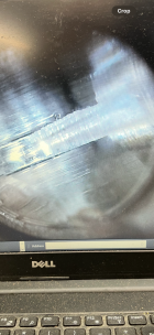

Reamer leaving burr
Anyone have any suggestions for removing burr from reaming?
Also what would you suggest for prevention?
Any suggestions would be appreciated.

I'd say it's either that your lubricant is ineffective, which means your reamer is now dull. Or your speed is too high, which means your reamer is dull. Or your reamer was dull to begin with.
As to what to do with it now? I'd try the shoot once, clean including bronze brush and solvent, repeat 10x minimal approach and see what you have afterwards.

Thank you for your response…..the reamer is brand new and seems to be really sharp and the last .005 was cut by hand so speed definitely wasn’t a factor, boelube was used as lubricant.
Sounds like the shoot, clean, etc method might be in my future.
Where's the burr? Where it's kinda crunchy looking on the land on the side towards the top of the picture?
I have one reamer on which it appears the corner of the stone on the grinder was rounded off. A QC issue. Consequently, the throat portion wouldn't cut and smeared the lands just like yours is doing. I need to send my reamer back to the maker but just haven't gotten to it. I already have another. WH

What brand is the reamer? Looks like possibly the cutting oil is breaking down or this was cut dry?

What was your procedure? Was the chamber roughed in before reaming or did you cut the chamber full length with the reamer?
Another question- Was this barrel new?

This is a 6ppc….entirely cut with reamer and the barrel is new.

Under magnification look at the throat area. Primarily the leade. Looking at the flute face has the edge deteriorated showing a shiny line instead of clean cutting edge?
and a couple of other things besides the burr, where its cutting the groove dia. is pretty nasty also and you need a smaller bushing there is the beginning of galling in front of the leade..
Following the lower edge of the land to the left. It appears there is a corner where the land narrows.
Am I seeing that correctly?
Those angled cuts in the groove lead me to believe the throat is off center. They both point to that land instead of in the same direction if it was just ratchet. I bet 180 from that we would see lapping almost back to the neck. Either way that reamer is dull. New or not.
