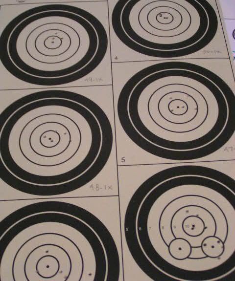

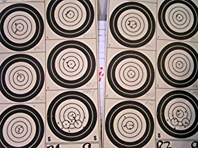

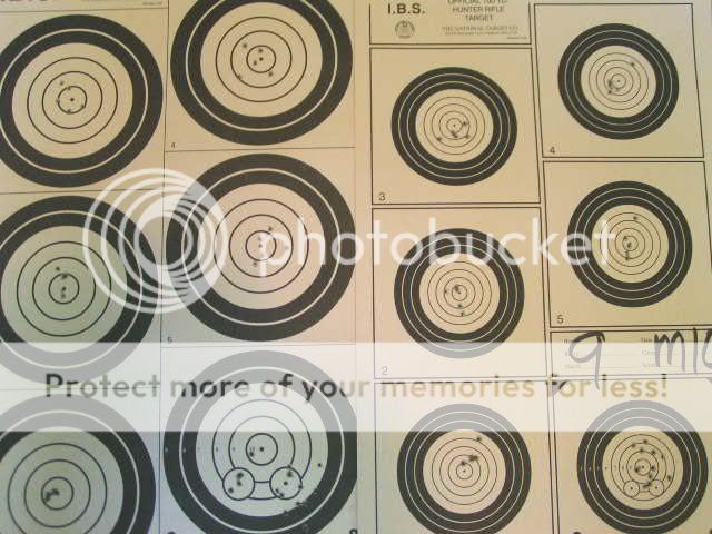

In the RF BR matches I put on we shoot at 50 yds and 100 yds. At 100 we use an IBS 200 yd Hunter BR score target. We shoot 5 shots at each record bull for a total of 50 points. We only allow one X per bull. 20 mins time allowed.
On this target the 10 ring is 1". In nearly 2 years of trying, nobody has shot a 250 target. A 5X target has only been done once. In Sunday's match there were two 249s.
I also allow the 17's to shoot in their own class in our matches. Same basic results. No 250s ever shot. Regular 247s.
This is with some excellent windflags.
Shooting 1" at 100 yds consistently, day in day out, and having a specific circle to hit is impossible from what I have seen. I see groups under 1/2" regularly when scoring the matches. On the same target there will be another group that is 1.5" to 2".
There may have been targets where all the groups were under 1". But none have been centered in the 10 ring.

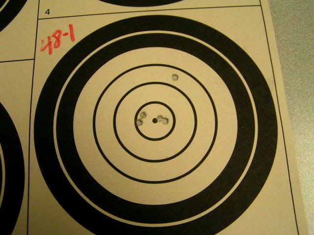

Slow twist Suhl
Annie 2013 when testing to see which IBS target to use [ 100 yd or 200 yd ? ]. The wind laid right down and I was able to get 5 off in one condition on the lower LH bull.
15 shots @ 50 yards 22lr
10 shots @ 100 yards 22lr
10shots @ 100 yards 22lr
