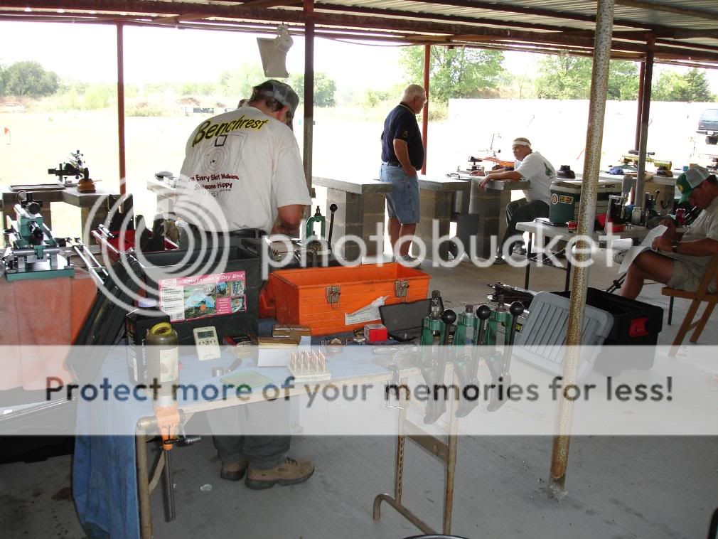

here is a pic of Jackie and his 3 partner press setup at the range.

ntexaslongshot said:
they are great little presses. and they'll work fine for things far larger than ppc and br cased cartridges. i've used mine with 7 rem mag and 338 Lapua with no problems.
That's them all right. Looks like the Denton [TX] Range. Nice range, nice folks.
If I recall correctly that's Mike Stinnett's home turf/range. Another fantastic story in itself: http://bulletin.accurateshooter.com/2013/08/mike-stinnett-breaks-the-unbreakable-record-with-0077-group/ :)
