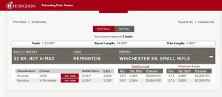

This might suggest they are the same still.
They seem to still be the same or so close, it does not matter. Let your rifle tell you which one they prefer in grouping.
My lot of 2230 is 2007, my X-Terminator is 2009. 2230 has no country of origin. X-Terminator is made in Belgium.
