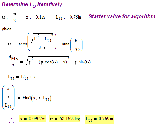

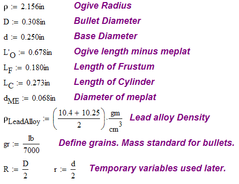

Here is an example of how to find the area of a bullet with great precision. In the example the Radius of the ogive is know. I can determine almost any of the other dimensions very easily with a micrometer and calipers. The radius is the only thing thats bogging me down and preventing me from completing this.
This example is a tangent ogive.
I am mostly working off this sites info. I have emailed the author to see if he know how to determine the radius.
https://mathscinotes.wordpress.com/2011/01/12/ballistics-ogive-and-bullet-shapes-part-2/
