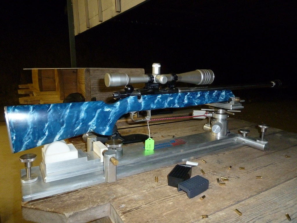

Here's the only Bruno-McMillen stock I've personally seen or handled, it's on the rifle I'm currently using, and it's fiberglass, not carbon fiber.
I basicly like this stock but, the only think I don't care for on this stock, is that as you can see the fore arm narrows from just in front of the action, to the end, so as it slides rearward on the front bag during recoil, there is space for lateral movement.
