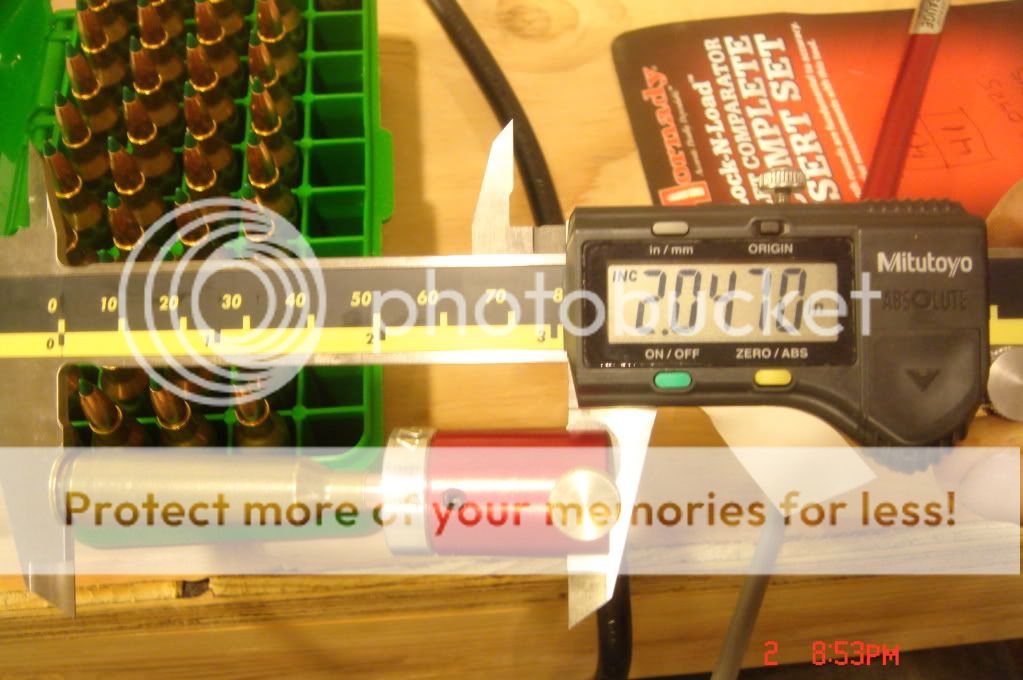

i am loading up some rounds to test in my 22-250 to see what seating depth this rifle will like the most. i am using a hornady bullet comparitor with a mitutoyo caliper to check the length of the cartridge (from the base to the ogive). after seating the bullet and checking the length, the seating depth of the bullet seems to vary a lot even though i haven't adjusted the seating die. the seating die is a forster with the mic.
i seem to get routine inconsistencies of 15 thousandths although i have had much more, up to 90 thou on the most, although that was quite a bit higher than the norm. so my questions... is this normal?? is this this acceptable??? what causes this...? i suspect that the difference can be accounted for because the seater is pushing the bullet into place from a different place on the bullet, where as the comparitor is taking the measurement right at the ogive (or closer to it anyway) or possibly just differences in the bullet??
Is it safe to assume that my bullet seater is working properly? give me your opinion please. thank you
here is a couple photos...two different cartridges, two different measurements, same seating depth on the die.
.015 difference in seating depth would not be acceptable to me and is nowhere near the consistency I have seen with my Forster seating dies in any caliber. There are a lot of variables to be considered one is consistent neck tension, has your brass been fired very many times and is all the brass the same brand and/or been fired the same amount of times. Not sure which bullet you are using. If the base/boat tail of the bullet is getting down into the neck shoulder junction and is right there in the unsweet spot I have seen some variations there before. The same would hold true if there is only a small amount of bullet in the neck. The example you pictured is only .0045 different but even that is more variance than I'm used to getting in my loads. I don't normally more than .001 difference between a whole batch.

Since you have loaded rounds, measure the OD of them, then measure the seating depth. I found that cases with the thinner necks, invariable the projectiles seated up to .003" deeper. From what I can gather guys using no turn necks with Lapua brass have very consistent brass right out of the box.
Anyways, measure the OD of your loaded rounds (use a micrometer) and you will get a pretty good handle on whether or not the neck thickness is a culprit and needs to be turned. I would expect a relationship of thinner walls = greater seating depth to come out on average.
With the Co-ax press the dies do fit a bit sloppy but that's just part of it. The die will be pushed up and stops against the part that holds the die. This is normal and I use the same press with the same dies. I got to thinking today and I remember having a similar problem and it was with a 22-250 and 50 Vmax when loading for a friend. His dad had re-sized the brass and it was all different headstamps and just a hodge podge of a mess with different neck tensions. Sounds like this isn't exactly your problem as the brass is all the same but I'm betting it comes down to varying neck tension.
