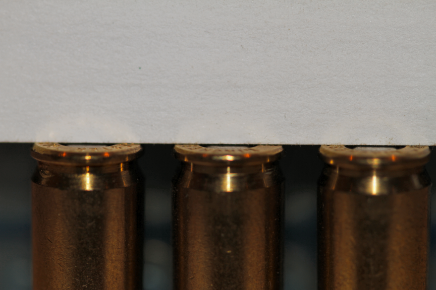

I use hand priming tools and I seat a primer till it bottoms out and here is my reasoning. Here are a few factory new primers.
Looking close we can see with new primers the anvil actually rises above the rim of the primer cup. Seating a primer till it bottoms out makes sure the anvils are seated all the way. Here a white card is laid on the case heads and the seated primers are about 0.003" to 0.005" below the case heads. If we want to get really sort of OCD we can measure primer height and pocket depth and know where we will end up with the primers fully seated but I just look them over. Hand priming you become accustomed to the feel and you know when they are at the bottom of the pocket.

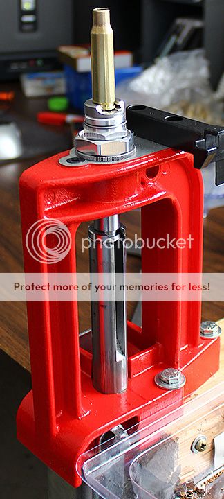

I use a Lee primer seating die in my press . It's somewhat slow since you have to feed the primers one at a time but seems to do a good job and is very inexpensive and I can easily feel the pressure needed when seating them. The depth is adjusted by the position of the die. (An old picture, I no longer have this press). And like Ron said, they should be slightly below the surface. One that is above is a recipe for disaster.

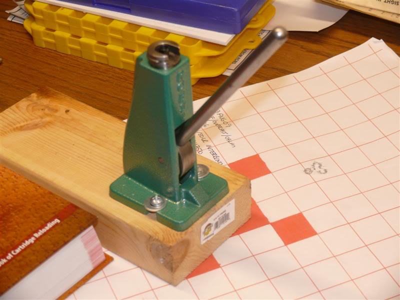

One of my old standby priming tools is this RCBS bench mount on which I can prime using one primer at a time. :) While hardly a high speed tool it works just fine and has a nice feel as I prime. Sympathetic detonation is not an issue. While I have a few old progressive presses lying around just about everything I load is done one at a time on an old RCBS Rockchucker or an old Lee O type press. Being retired does have a few merits like I am never in a hurry to get from A to B.
I should popint out the pictured tool is a file photo I found online which saved me taking a picture. :) If I ever see another one of these complete at a gun show I will buy it just for spare parts. They really work great.

I passed up one up around 1980 for $12. LOL. Believe RCBS bought Lachmiller out on this . Been looking for one forever.
A nice piece of equipment.
I have one of these and really like it. Feel?? Not so much in my opinion. However, I use my old standby Lee and then set the Holland's to seat the primer the same depth as the Lee. Then you can seat your primers to the same depth. Like the Holland's a lot.
