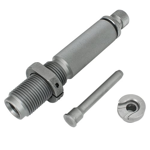

I just bought the Hornady swager below, you can't see it in the photo but it has a carbide swager that also rolls the mouth of the primer pocket. It is not rolled as much as the Remington case above but it gives you trouble free primer seating.
It is also the best and fastest press mounted swager I have ever used, but may not be as fast as the Dillon Super Swage 600. You just place the case on the ram and put the ram in the shell holder. And no fumbling around like with the RCBS press mounted swager trying "find" the upside down and out of view ram.
Hornady 041227 Lock-N-Load Swage Single Stage Primer Pocket Tool (.223/556 Only)
