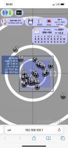

Is this capable? I mean, it’s a 6.5x47 and not a creedmoor, but it’s pretty close.
I'd say you would have to be on the top end of the 1% of shooters on this forum to be able to isolate the effects of .001 and .002 nt on one's groups. And I aint one of 'em!
