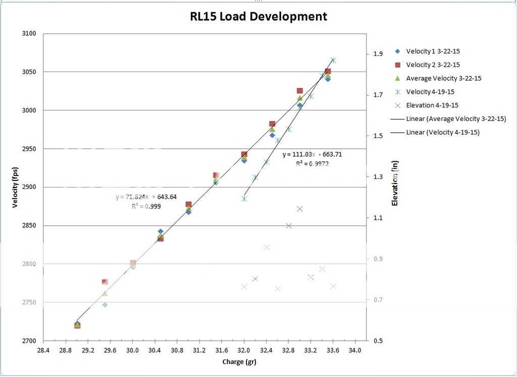

Folks,
I've been developing new loads for my new to me 6mm Dasher. I have been working with RL15 along with other powders. During my initial development on 3/22/15, I found that the gun likes to crater primers. So I embarked on getting a PTG bolt head for the bolt. This required the chamber with the new PTG bolt head to be re-headspaced. I checked the headspace with the gauges prior to replacing the bolt head and it was "within spec".
During subsequent load development today 4/19/15, I noticed that the slope of the charge vs velocity curve was significantly different. What caused the change? Was it change to the headspace? The different brass lot? The "tighter" OAL? The Temperature?

3/22/15 Cartridge Details (Stock Savage Bolt Head):
Temperature: 67
Powder: RK15
Primer: CCI450
Bullet: Sierra 107 MK
OAL: 1.802 (0.010 off lands)
Brass: ~6x fired Lapua (came with gun)
4/19/15 Cartridge Details (PTG Bolt Head):
Temperature: 59
Powder RL15 (Same Lot)
Primer: CCI450 (Same Lot)
Bullet: Sierra 107 MK (Same Lot)
OAL: 1.810 (0.005 off lands)
Brass: 2x fired Lapua (different lot)
Any thoughts?

If you had to guess Mike what would you put your money on? I'm just trying to learn something here.
If it was a temperature offset wouldn't the curve have the same slope and just be shifted up or down? I'm struggling to believe that a different brass lot is going to shift my 32 gr charge velocity by ~55 fps but stay the about the same at the top charge. Same goes for the change to the OAL. I guess I can run a mini experiment and run the same OAL as previous and see what the velocities do.

I thought of another thing I changed that may also influence the charge/velocity relationship. I was trying to reduce the bolt lift force and installed a thrust washer (and bolt cap screw spacer) in the bolt. I also re-profiled the firing pin face to flatten it out a little (to help minimize the cratering primer issue). In addition I backed off the firing pin spring retainer to reduce the amount of preload on the firing pin spring. I backed it off too much as I had two light strikes during subsequent firings. I have since turned it back a half a turn to minimize the light strikes. Does the force the firing pin imparts onto the primer effect the burn intensity of the primer? In other words does the burn hotter/faster when hit harder?
I can envision the lighter hit primers not having the same burn rate and thus the internal case pressure is reduced along with the associated velocity. But it still doesn't explain the change in slope? Why does velocity meet back up near the maximum charge (started seeing pressure sign)?

I think I will install the backup firing pin spring assembly (fitted to the new bolt head and adjusted to same preload as originally found) and repeat the last load development to see if the charge/velocity curve returns to the original. I think there is something to the impact force of the firing pin spring and the associated pressure/velocity at a given charge.
