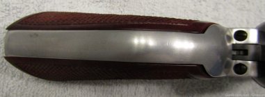

some more pics. As stated above, steel grip frames were/are available for sale. I will know in a few days, when I get it in my hands. I should have been more clear, grip frame vs. frame.

The frame in photo looks like aluminum but a check with magnet will tell. If you don’t want the aluminum color there’s always cerakote. Graphite black is really close to blued steel. We’ve done several at my work.

If you replace the grip frame with steel, you might also consider replacing the ejector rod housing with a steel one and also replace the cylinder pin with an oversized one. The steel ejector housing and grip frame changes the balance a little (in a way I liked) and the new pin helps cut down on alignment issues. I did all that as well as repolish and reblue and cutting the barrel of a badly neglected Ruger 7 1/2" .45 Colt that I salvaged/restored. Worth doing and make a good gun better.
