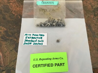

Just checked on ebay. Not sure on the detent & spring, but the seller might have them also. They're not mine.
been in contact with e-bayv guy,
Been in contact with the e-bay guy, he also has the detent, spring not a problem.
9 times out of ten the problem you desribe is a worn extractor, on Savages and Win push feeds, and to some extent Rem 722-700's. It lets go of the case too early in the cycle and the ejector has nothing to kick against. Jack First has the parts too.
Jack First has the extractor, I don't know if I need the detent, but they are out of that. The ebay guy has both, for about the same price. Thank you for the heads up, I'll keep them in mind, if I see this problem in the future.
Can you actually inspect the sliding plate/detent/spring, to determine if it is worn, or needs replacement?
New extractor, detent, spring, fixed the problem. Thanks to all.
