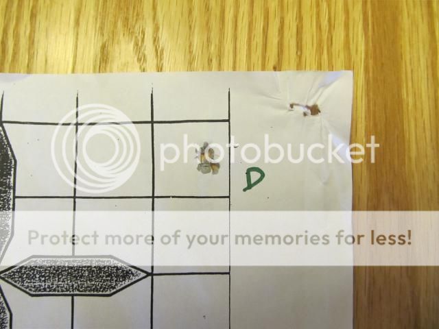

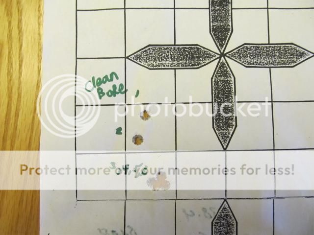

PRVI 22-250, shoulder bumped with a 7BR die, COW fireformed outside neck turned then loaded with the Hrn 105gr BTHP, fully formed case
Dunno about being junk brass???? That is a test load with 4rds... this group is 0.171"
We have too much snow to shoot far right now so playing at 100yds. Tuning loads that are showing promise to shoot in the the 2's 5ds.
Not bad for a mag fed, bipod shot rifle me thinks....
From a clean bore and fireforming loads (see the loaded rd in the pic above), took 3rds to settle the barrel and then the next 3 went into the same hole. I am sure that would be plenty good for club matches while forming brass.
PRVI is very strong and thick brass... I have not found any burrs on the inside of the FH.. maybe it is drilled. Seems to weigh and look a heck alot like another popular brand.
I do outside neck turn as I prefer thinner necks. Annealing is important like any other brand. Otherwise, I just load and shoot with quality components.
Works for me.
Jerry
PS Norma is the best out of the box brass you can buy but once I prep the PRVI, I get the similar on target performance and if I loose the brass at a match, oh well.. Norma is too rich for me to fire and forget.
