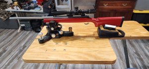

Looking for input on a Protektor Dr Rear Bag with the sloped top for use with a sling shooter stock (Angled not flat bag rider ). Will this work well for FTR ?

Yep. I keep one for tuning my traditional stocked rifles, usually hunting guns, works well. Just make sure to match the bag angle with the stock, don't turn the bag around.

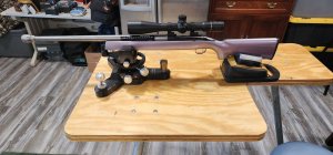

Has anyone used this bag with a short range BR stock like a Scoville or Kelbly KLP?
Yes sir I know of a few in IBS score that does. I tried one but the footprint was too big for my T-Rex arms to get around and be comfortable.
I used this exact bag for several years in VFS benchrest. It performed well. As noted, it has a large footprint, so be aware. For sure, it is not a bag that I would recommend for squeezers...
