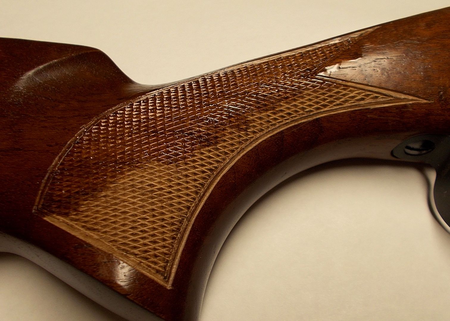

I haven't been checkering for very long (still very talented at finding new ways to screw it up) but so far I've been cutting Tru Oil with a bit of mineral spirits and very gently sponging it onto the diamonds, applying just enough with each application to cover them but not saturate them. One hand holds the sponge with finish mix, the other has a paper towel/napkin ready to gently wipe or dab away any excess. I do that a few times 'til the checkering pattern stops being so thirsty and the finish matches the rest of the stock. If finish does collect in the grooves you can clean them out with a single line checkering cutter and V-cutter along the borders, but if you screw up you've got a nice setback to deal with. This has worked pretty well for me, so far.
That's a CZ 452FS stock I re-cut with some finish being applied for the first time. My camera noticed the excess along the right edge before I did.
