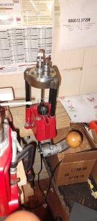

So picke duo one of these lil lee turret for like $100 with 10 extra heads. Thought why not for that price... Need to get a longer handle and honestly dont like how it doesn't have came over but anyhow have a question.
