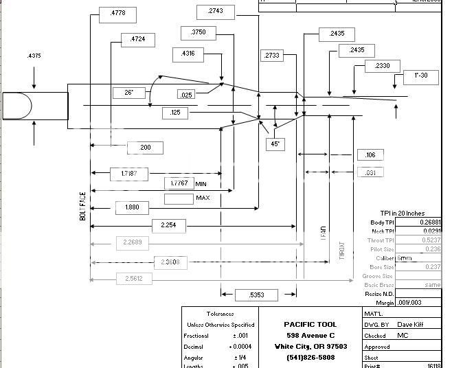

Here's a pic of the chamber:

Mic the necks of your remaining ammo. If you're getting good neck tension sizing with a 0.271 bushing, you probably don't have adequate chamber clearance for the necks. Your loaded ammo will tell what your chamber size needs to be.

Is the .271/.272 the brass neck dimension of a loaded round? The loaded round dim. is the one to focus on.
I recommend having the shop run a standard reamer in to avoid situations like this.
As was said, custom chambers require a lot of scrutiny to get everything to function without problems.
Also, off-the-shelf dies are not designed to properly size brass from match chambers.....generally speaking.

In reading your posts and replys I'm not convinced that heat had anything to do with it, especially after your last post. Any minumum spec chamber raises the issue of too tight of a tolerance and requires closer attention. A 273 nk shooting 271-272nk loads definitely raises that as a possiblilty, you might want to take a chamber cast to verify the neck dia. Because of the amount of rounds you have fired through this rifle with no problem I would look for something that affected the load integrity when loading. I've had 2 instances with friends that mirror your experience. First one had used 'Mothers' rim polish in his cleaning media to polish cases,learned that right here on 6mmBR), actually he was too cheap to buy the good stuff. He had media that clumped inside his cases about 1 in 10 would have this crap in it. He was loading one case at a time through an electronic powder drop so didn't eyeball it. Boom...instant blown primer and trip to smith to hammer open bolt. The other had some lubricant inside his cases, he also was using an electrionic powder drop and about every 10-15 cases if his load was in question he would dump and reload, instant extra 5-8gr's that were sticking to the inside of the case. Boom...you know the rest. On both we didn't determine what it was until we pulled about 20-30 rounds and inspected them, not one or two. Ruling out the heat or barrel obstruction your basicaly left with either a tolerance issue, media in the case, or too much powder to create excessive pressure. The damage to the bolt looks like it was caused by the method used to remove the case or a manufacturer defect that surfaced because of the pressure. Good luck and glad you didn't get hurt.

Talked to the smith today, he suggested fixing the bolt, installing a Sako extractor and doing some more troubleshooting. In his experience he feels that recutting the chamber isn't the answer especially becuase he's shooting a tighter necked match chamber than I am without turning.

What kind of clearance should I be looking for between the loaded round and the neck?
For a varmint rifle, no tighter than .002.

You are on the ragged edge, either neck turn for more clearance, or re-do in a more foregiving SAAMI chambering.
