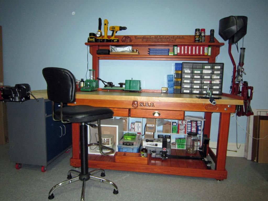

For an Omega - and to protect from drafts, I put the scale, trickler, and some LED lights inside a cheap 15" Storage Cube. The only photo I have with me now shows the storage cube on the lower shelf, left:
