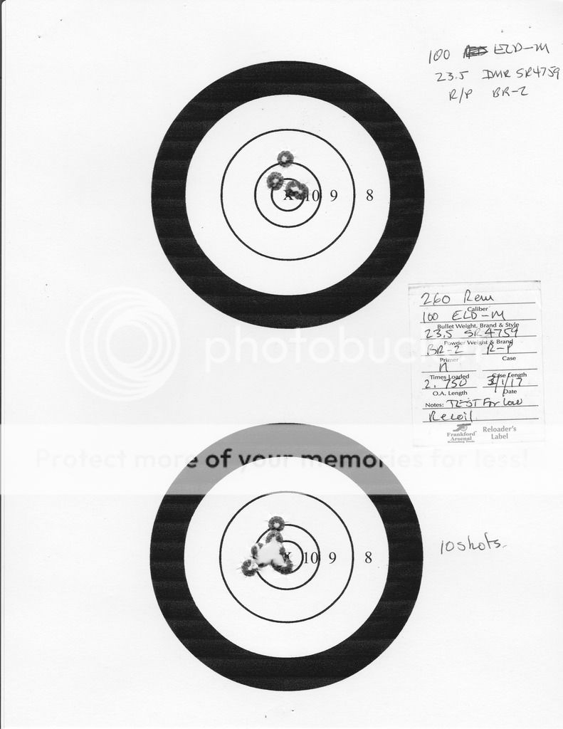

Back a few years ago, I messed up my shoulder and had to look for low power alternative loads for my military 30-06 and 308 rifles. Trail boss was not a good substitute then I read something about IMR SR 4759 or Accurate 5744. I tried both but 4759 worked the best. Was bot low recoil and accurate. Unfortunately IMR has now discontinued the powder but I managed to get 12 pounds of it, so I figured I am set for the rest of my life. I thought about the 260 so I loaded up some trest rounds to take to the range with me to try it out.
Bingo. 23.5 grains of 4759 behind a 100 gn ELD-M bullet was only 1 MOA low at 100 yards. AND it was really accurate. Check this out. This is on a F-Class target scaled to 100 yards shot prone on all of my F-Class equipment.
These will not burn up the leade and are low recoil so you can concentrate on form and results rather than getting pushed around.
Thought I would share the idea with the rest of you. If I every do run out of 4759, 5744 is next best if anybody want to try it.

As a follow up on these low recoil loads. After my initial sucess with the SR4759 powder and 100 gn ELD-Match bullets, I loaded up 50 more for practice. Also based on a prior posting in this thread, I also loaded up 19 more using 28.0 H4895 loads. Last night was my time at the range to start practicing position for an upcoming 1000 yard match. So all of this testing was done from prone and using my Atlas bipod with sand bag rear, just like I would shoot in competition.
I decided to test the H4895 loads first on a clean barrel. I used 4 shots as sighters to get centered up, then shot 3 of my standard 1 inch 10 ring, 1/2 inch X ring practice targets. I shot, 50-4X and thought this is going well but it was a loose group all over the 10 ring. Targets 2 and 3 where even looser at 49-3X each.
Then I pulled out the 50 rounds of 23.5 SR4759. It took a bit to get the barrel fouled and the groups to not to drift. But once that happened then the last 5 targets were 50-3X, 50-4X, 50-4X, 50-3X and a 10 shot group of 100-5X. All of these groups were tighter than the H4895.
I know that unless you have some SR4759 in your stockpile it is no longer made but, at least for me, it is definitely more accurate on low recoil loads. This is now the second gun I use SR4759 with with great results. My other gun is a 1903A3.
