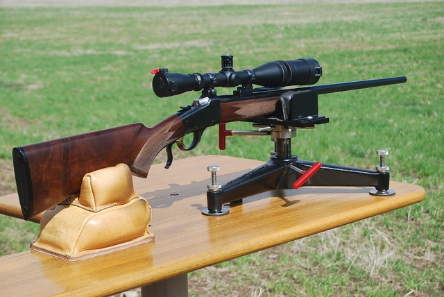

I'm no help at all IRT the PPU Hornet ammo as I handload, but as you have an 1885 Hornet Low-Wall as I do, I'll share mine. It was chambered to "K" right away, and in the years since it's launched a fair amount of PD's, squirrels and rock chucks, mostly using the old Nosler 45gr SP, now discontinued.
You'll never regret going to "K-Hornet", and it's a great marriage in one of these sweet little rifles.

The little 1885's are great little walkabout rifles, and no slouch in the accuracy dept. either once the favored load is found.

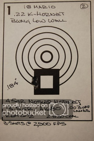

Here's about the best mine will do....plenty accurate for all the grass rats, and head shots on chucks out to my personal limit for that critter with this rifle; 150 yds.
Years ago once I found out how accurate this bullet was, I laid in about 2K....still shootin' them. :)
