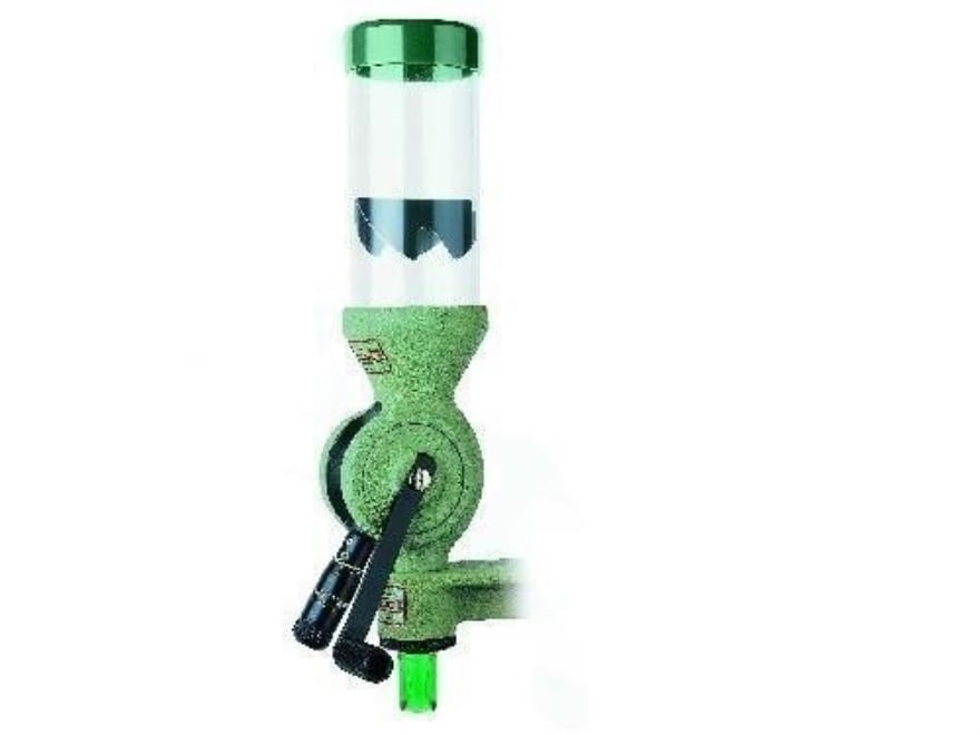

What I use is the RCBS Uniflow that I have had for years and come to think of it it was my first powder measure. What I finally did was buy the micrometer adjustment screw and when I weigh the powder charge, I add it to my chart as a quick reference.
I also use a Dillon 550 press and with these I added the MrDial which is calibrated, and I count the revolutions of the dial + the number + the increments, and mark that down.

I drop pistol powder (231) from the measure directly into the case once I set the micrometer to the appropriate setting for the load. I check every 10th load dispensed on a scale. Always within + or - .1 grain.
For rifle, I only use 'stick' powders which do not uniformly meter through my powder measure therefore I dispense a charge from the measure then make the final adjustment using a scale and a powder Trickler. It really doesn't take that much time. I set the measure to drop about .3 grain below the desired charge weight.
On my reloading chart, I record the micrometer setting for each powder and charge weight. Adjustment from one powder or rifle to another is quite easily accomplished.
