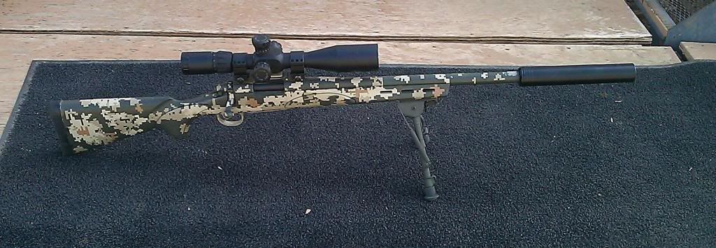

That hydro dipped is sweet. How much $$$$? What kind of paint do they use? Is it solvent resistant?
The whole gun and supressor was some where in the $300 ish range.
They under coat it with beige Duracoat, and then dip it, and then clear coat it with Duracoat.
It is solvent resistant as much as clear coat can be. I wouldn;t let it sit on there for sure.

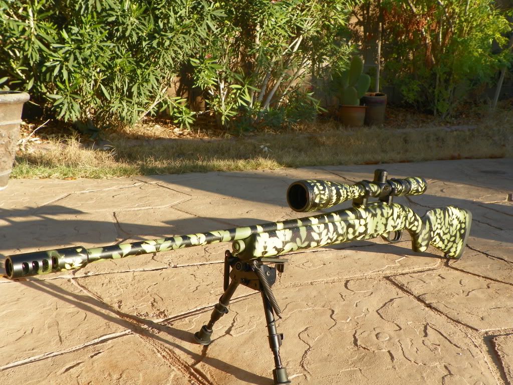

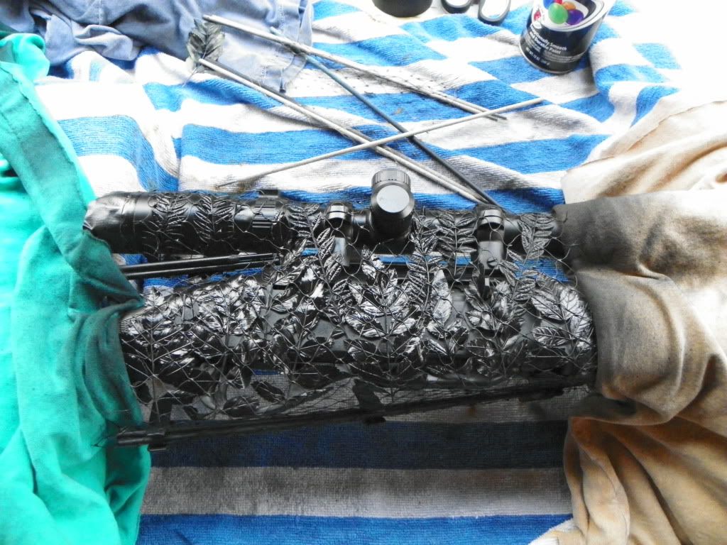

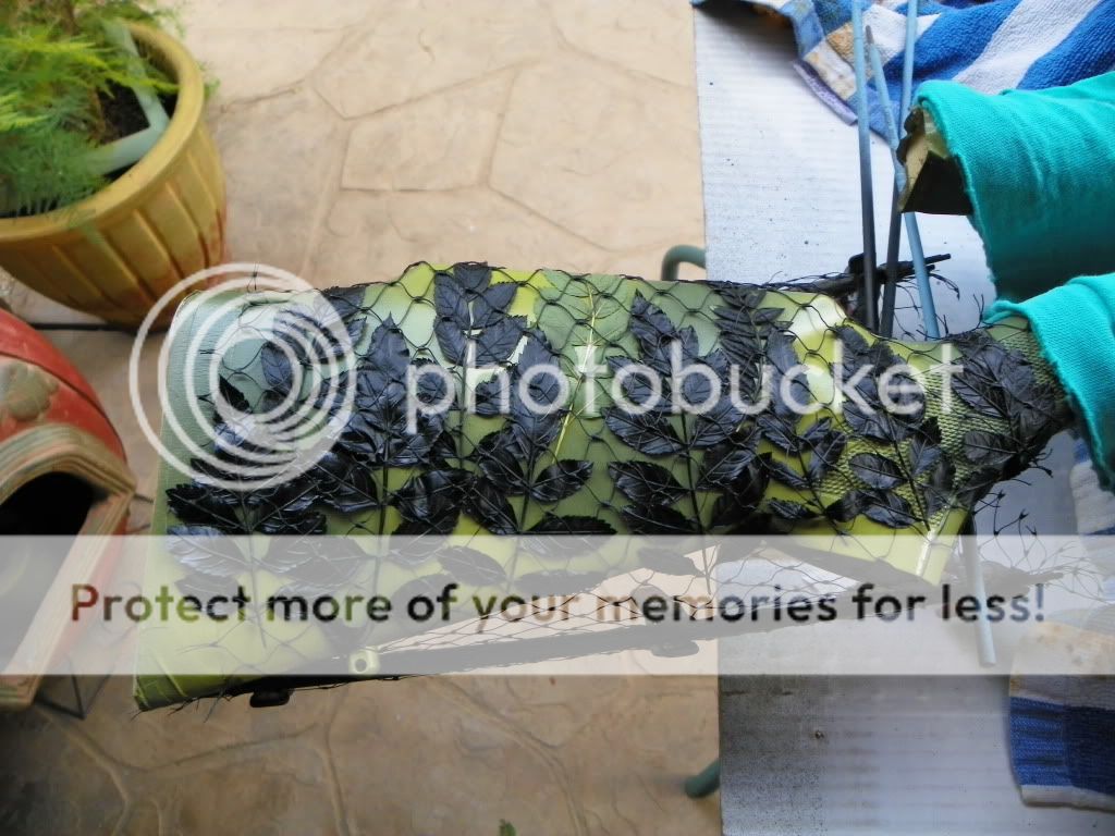

This my 7400 Rem, 308 that I painted using Krylon paints. I cleaned the rifle with brake and parts cleaner first and then painted it with different shades of sage green and then got some leaves and held them in place with the small netting from those bags that onions come in and dusted in between the leaves with satin black, ( in 1 foot wide sections). Then I sprayed it with satin clear and it seems to be holding up pretty good. I live in AZ and tried to paint it to match the sage and juniper bushes.
