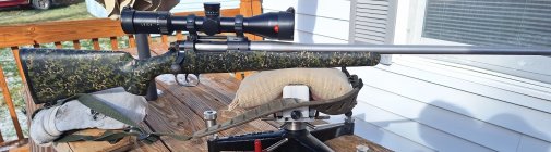

This year I purchased a new Ruger American Gen 2 Predator. Cleaned the rifle and looked down the bore, looked great, and I have about 4 ranges trips on the rifle. I clean after every range trip using Kroil and Hoppes #9, works pretty good. After my last range trip I decided to take a look down the bore and there appeared to be pitting, at least it loos like that to me. Why on earth would a new barrel pit like this, if is pitting. I store the rifle in my den, below ground with a dehumidifier and none of my other rifles, shot more than this one, show this level of pitting, I am at a loss. There is also some rings in the second picture that I have no idea what they are. Any ideas folks

how’s it shooting? If it printing good groups on target, I wouldn’t worry about it. It looks better than a Savage barrel and they shoot darned good!!
I have a 6x45 that looks a lot worse than that, and trust me, it has no impact on accuracy! The Xcaliber barrel I have a 1-8 shoots lights out with 65 grain Bib bullets at 3302 fps and .3 moa groups. I am sure glad I spent the time to shoot the barrel, leason learned is, never judge a book by it's cover. Let it tell you how good or bad it is by shooting it!

The pits are like from impurities in the steel. The best reasonable explanation I've seen for the rings is they are from the drilling operation. Some of the cuttings are not flushed away and are making these marks. The hammer forging to create the rifling does not completely eliminate them.

All of those spots around the barrel radius in about a 2" length of the barrel. Definetly not from chips, but impurities in the steel. This is thanks to the barrel steels we are blessed with today. Even the premium barrels are not what they were 20 or 30 years ago, I know, I still have a couple.
