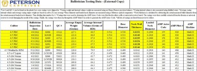

I just received 150 Peterson 6BR cases.
This is the difference in the smallest part of the neck thickness as compared to a Lapua 6BR.
The Lapua, (bought this year), only shows an average .0003 variation in the wall thickness at the neck, while the Peterson is showing an average .0008. taking into consideration the wall thickness, the Lapua is about .0005 thicker at the neck.

An indication of the difference in the necks of the Lapua and the Peterson is the micrometer measurement of the loaded round at the base of the 80 gen Barts Dominator bullet. We are looking at a full .002 inch.
But just before the rain hit I managed to shoot two groups with the load I developed. The velocity with the 31.5 grns of H4895 was an average 3300 fps, .002 neck tension, about .010 into the lands.
The Peterson Brass will shoot, even with the what appears to be a lot of neck clearance. I don’t know why Peterson chose to make it that much thinner than Lapua,

That'll get it done. I'm not shooting my 30's as much these days and wonder how it holds up to pressure in the small 6's. I know you load mostly upper window so would like your feedback on that when/if you ever do it. 6ppc/6BR/6Grendel data. I hope it holds up well. Wondered for years why an American brass maker hadn't stepped up and made brass as good as Lapua.
Has Petersen released any info on why they can’t lock into a standard dimension and maintain it.
If they are going to go heads up against Lapua in the Competition Market, that being all of the Disciplines that use the 6BR as a parent case, they have to do better.
