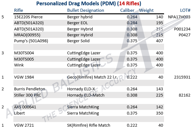

The AB Mobile Lab has now seen half a dozen events, and this time we changed the game. At the Precision Rifle Expo each of our team members was not only able to give a class but we performed a public demonstration of the Mobile Lab's ability to upload Personalized Drag Models from the field. Users were able to shoot their rifle and within a short period of time download that rifles PDM via the AB Connect System and use it. In many cases before the demonstration was even over their PDM was already live and ready to use. This was further demonstrated when shooters like Mitchell Cox from Barrett were able to get a PDM on the spot, and turn around using that PDM to get a 1st round hit with factory Berger Ammunition at 2125 yards with his own rifle. He stated that he had never shot beyond a mile before that.
We were able to upload 12 PDMs during the live demonstrations/classes throughout both days. PDMs for AB Training Division, Barrett, Burris Optics, Chase, Corbin Shell, Pierce, Stiller Actions, Vudoo Gun Works, David Lott, Brian Wink and more.

You have BCs (G1, G2, G5, G6, G7, G8, R4A, Gsp....) Which means you take a known model, and then attempt to predict your current bullets flight by scaling. However you are assuming that it will perform the same at high, medium, transonic, and subsonic speeds.
You have CDMs. Which means you are not using a BC at all. Instead you are modeling the actual bullet in flight and just using that. Out of a standard test rifle. Of course no two rifles are the same. People use different twist rates, muzzle devices (suppressors, brakes, tuners), different rifling (4, 5, micro, gain twist), chassis vs railgun vs stocks, etc.... So variations do exist which can have an impact on the bullets. You also can have (some manufacturers are very good about minimizing the changes) variations in bullets from lot to lot as the dies are replaced.
Then you have a PDM. Which means that you take a specific users rifle, and ammunition load, bullet lot, etc. and you simply fire that rifle over the radar system. You take an average (say 10 - 15 shots) and use that to compile a drag model with that users own setup. So the bullets flight prediction model is directly from that users system, and is compiled from live fire data.
Basically with a PDM a user gets to take the real world radar measured flight and input it into the system for predictions.
You can read more here: http://appliedballisticsllc.com/ballistics-educational-resources/custom-drag-curves/
