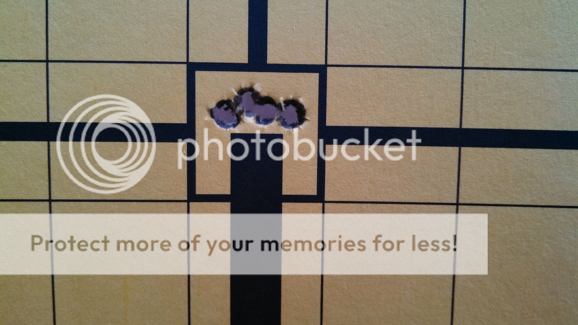

Shhhh don't tell that to my AR you might hurt its feelings. This was the first 5 shot group out of my JP enterprises 223 at 200 yards after break in.
Now here's the second 5 shot group after I cleaned it.
And after another cleaning here's the third five shot group from the rifle at 200 yards.
Then there are the witnesses at Birdogs range where we setup at 300 yards and I shot neck and neck with my AR against a custom bolt gun at tums.
