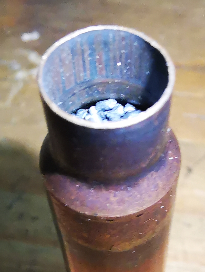

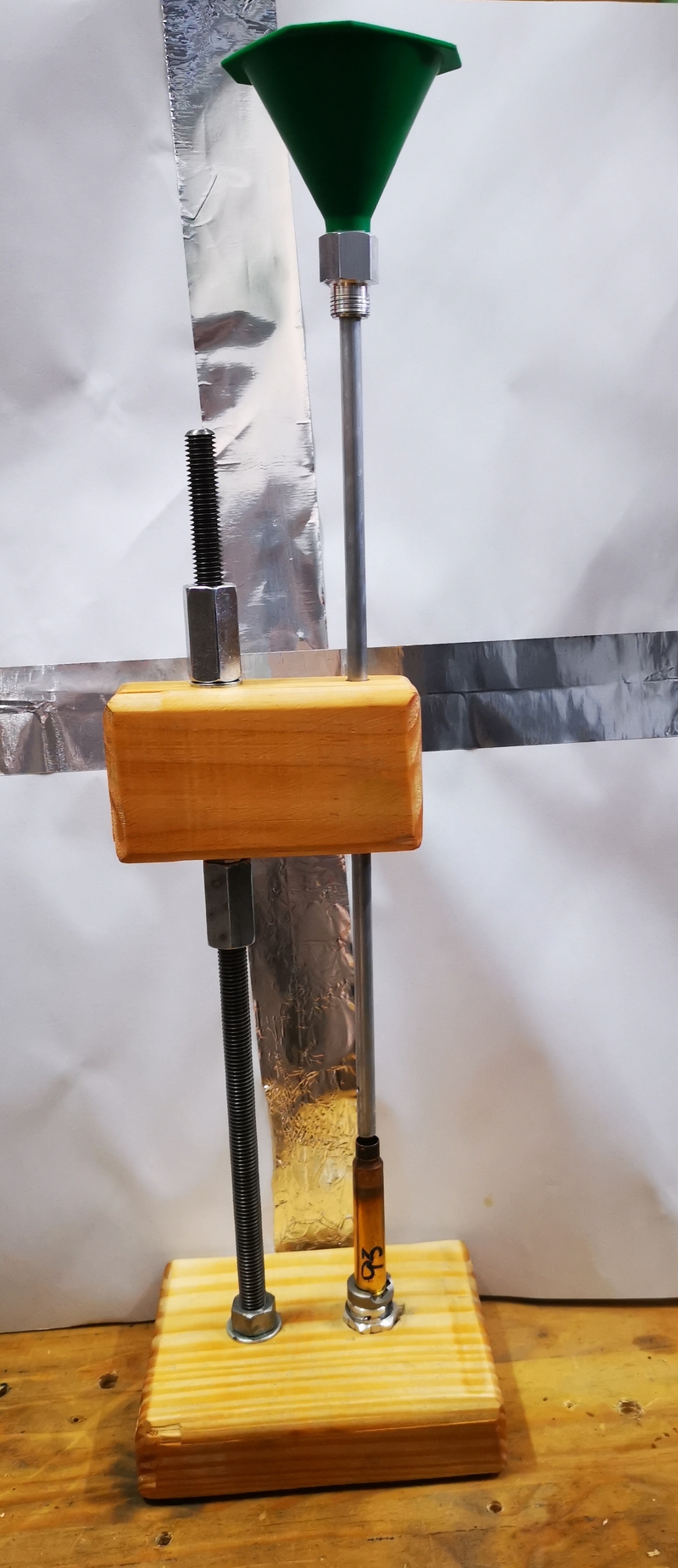

There is no need for vibration if the drop tube is long and thin enough.
I've got a 50cm drop tube, internal diameter of 5mm. I found the 5mm size more efficient than something a bit bigger. The smallest practical size is large primer diameter.
It goes from this
to this
That is 105 grains IMR 7977 in a 375 RUM.
This was the test rig, it's using a large pistol primer tube. The current version is using a 50cm aluminium tube with a 5mm internal diameter.
It goes from this
to this
