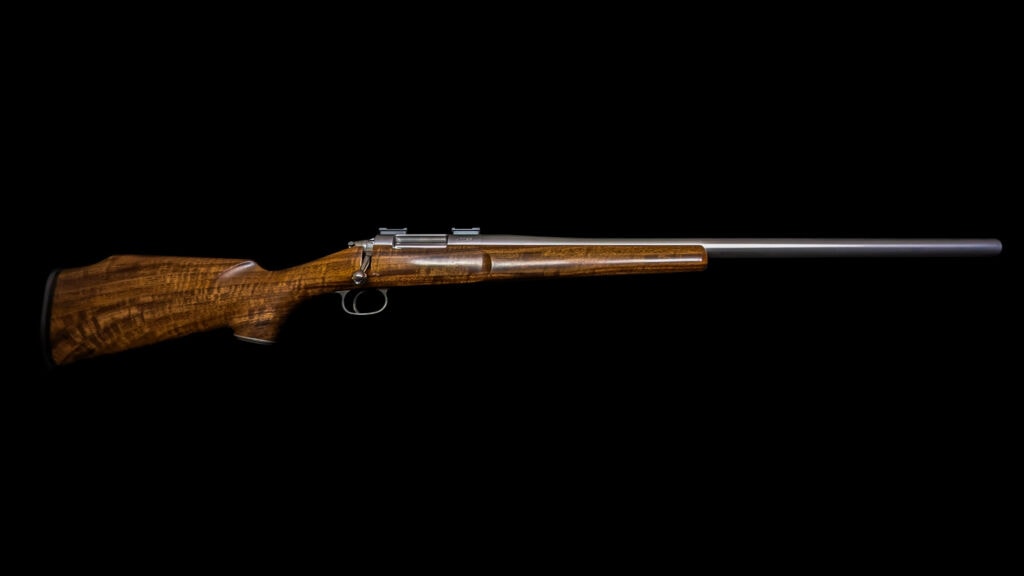

I purchased a Parkwest Ace .204 Ruger this winter. It's a single shot, with a Shilen 12 twist, #17 contour barrel. It came with a trigger tech, which was replaced with a jewell. The fit was excellent, very good bedding job! I topped it off with a Swarovski Z5 5-25x52 with BRX reticle.

The rifle is a shooter. I used Nosler brass and tested 39 sbk and benchmark. I ended up at 27.1 of benchmark. Tested F205M, CCI 450 and 7 1/2 primers; 223, 225 and 226 bushings. Ended up with F205M and 226 bushing - light tension seemed to behave the best. Increasing tension - pressure - vertical etc
Confession: Keith Kilby shot the F205m groups... today we were at the range and there you have it. I had previously shot that combination and it shot good, his was a mite better.

Very sweet set up, Would be curious to see what remington 71/2 do

I tested them, didn't play well. I should add that I took a 100 rounds of virgin brass and used them to figure out what was going to play. Did final tests with the once fired brass. I've been burned before making a decision to quickly before the barrel settles in... Also the barrel cleans easy peasy.

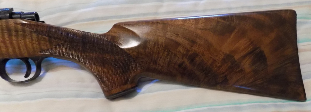

Have never understood why Dakota, now Park West, didn't have a better marketing scheme. They are wonderful rifles made every bit to as high standards as most any custom but marketed through hock shops and the like, except for First Stop and maybe one or two others. Seems like a good marketing program would take them where they need to go for long-term success.
I am surprised that a rifle of that quality and price range does not have checkering, to me the stock looks unfinished without a small amount of checkering. Just a small tasteful pattern on the pistol grip would enhance the looks dramatically.

Perhaps I should have phrased it differently. As a rifle selling in that price range there should be a small amount of grip checkering without it being a $295 add on.

That’s more of a prairie hunter/varmint style stock with a wider beaver tail fore end. People usually don’t put any checkering on stocks like that. Checkering would muddy up that pretty wood anyhow

It seems that we have differing opinions on what muddys up the wood or enhances it. I don't find that the small amount of tastefully done checkering on the grip detracts from the wood at all. To me not having at least some grip checkering leaves the rifle with an unfinished look.
I understand them charging for upgraded patterns, but my point was that a rifle selling at that price point the buyer should not have to pay $295 upgrade fee for a minimal checkering pattern on the grip.
