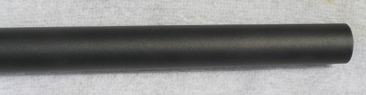

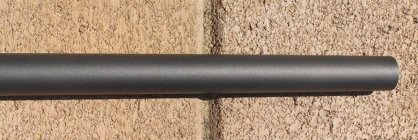

I’m getting my stainless HV Krieger black oxide coated! Took an old stainless barrel in just this Friday, that I had half beaded blasted. And left the other half to see which finish I prefer.
When I picked it up it looked identical to black manganese phosphate steel. I compared it to the finish on my sako phosphate trg & I couldn’t tell the difference...... very happy.
