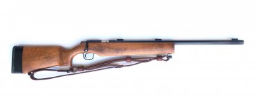

Hi.
I purchased in 2013 from CMP the NIB Kimber M82 Government rifle you see in the attached pictures. Although I have not fired it, I did disassemble and thoroughly cleaned it. Below are the shortlisted scopes based on feedback from other members.

I wouldn't begin to tell you what scope to use, I will say that it is a beautiful rifle. Most of my 22s have variable power scopes that the highest power is 14 or 15. Thats OK to 100yds but further you may want more power. None of mine have enough internal adjustment to get to 200yds. If making the main crosshairs POI at over 100yds look for a better scope that has plenty of internal adjustment

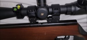

I use BKL-558 MB base on my Anschutz smallbore rifle with Sightron S3 10-50×60mm with illuminated moa reticle for smallbore f class. Bought Sightron from LanceXXX. Burris low Signature xtr rings.

I ordered a Sightron SIII Precision Long Range 10-50x60mm, 30mm tube (SKU: 28010) and an EGW picatinny rail 20 MOA (SKU 42702). I need to decide on scope rings. Which of the following 4 scope rings do you all recommend?
  • Kelbly’s rings [$207]
  • Seekins rings [$149]
  • Leupold Weaver style PRW2 rings (SKU 174085) [$89]
  • Burris XTR Signature rings (SKU 420223) [$86.30]. A member advised me that the Burris rings are the only ones that will allow me to choose my best sight in distance for shooting at 200 yards and beyond and then be able to set my scope up optically centered. There is some benefit to being optically centered and my Sightron SIII only has 25 MOA up or down in the specifications from its center. If I plan on only shooting 25-50 yards, anything will work
