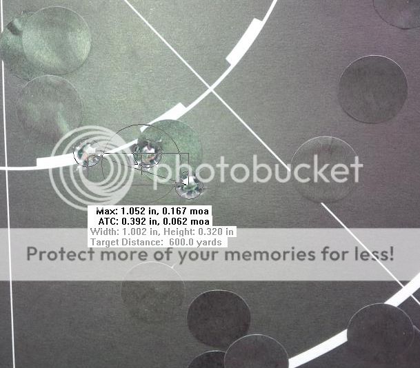

I would go straight 284 myself, less cost with dies and they just plain shoot... this one is a 8.5 twist TrueFlight barrel with 180g Berger Hybrids and H4831SC, also have 2 other barrels for her, a Brux 8.5 and a Kreiger 9 Twist, but I'm going to stick with one barrel at at time until it pukes, then screw on the next. I shoot FOpen class. This was with 284 Win brass turned to .0126" for my tight throat, .310 NK. This barrel has 1516 rounds down her now, mostly 180g VLDs, just testing the Hybrids now.
