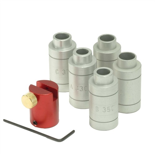

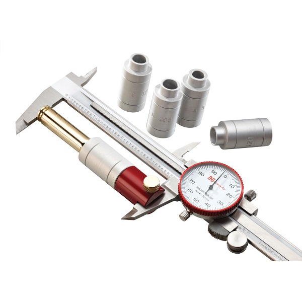

What is a good tool for checking bump in the .223? I have always just run the die down to the shell holder and let it rip. It turns in groups less than an inch with an economy stainless barrel. Chambers easy.
http://www.brownells.com/reloading/...ck-n-load-headspace-gauge-tool-prod35168.aspx
I prefer them on a digital caliper though so I can easily zero it with the gauge. There are additional inserts that allow you to measure your case base to bullet ogive as well.
http://www.brownells.com/reloading/measuring-tools/bullet-comparators/lnl-comparator-body-w-14-inserts-prod36535.aspx?avs|Manufacturer_1=HORNADY
These arent actual measurements mind you. But they will be accurate relative to your own equipment. Your neighbors wont give the same numbers, but your own personal numbers should be repeatable with your tools. So its a relative measurement vs absolute but thats all one really needs.
