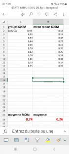

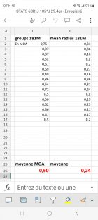

Here's the statistics to date at 200y/181M and 656y/600M, mean radius and group ES. (all numbers are in MOA)
All 5 shot groups, all shot counted, including "fliers" in all meteo conditions.
I don't do competitions, Just shooting for fun but, I like to see nices tights clusters!
Do you think if I would replace the barrel with a premium one, Bartlein or Krieger my average would be much better?
What do you think ?
Thanks!
Mat

I don't have any good answers for you, but since you didn't mention it in your descriptions so far...
Did you do a full work-up to arrive at your optimal seating depth?
Also, have you tried other similar bullets like the Berger 105 Hybrid or 105 VLD?
