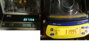

Here's a few charges checked with an analytic force balance scale (A&D ER-182A), readings converted to grains (X 15.43236) then weighed on my EJ-54D2.
This is NOT a normal procedure :)
ER-182A EJ-54D2
31.9913 31.990
32.0481 32.050
32.0512 32.045
31.9809 31.980
31.9885 31.985
31.9789 31.980
32.0625 32.065
31.9362 31.940
31.9825 31.980
31.9705 31.960 (- 2 counts)
One hand trickled charge that took a few tries, with one count error on EJ-54D
