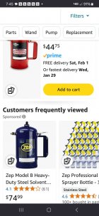

I use Zep spayers now with Stoddard solvent.Air em up with shop air.Always clean,portable.Wash down engines ,motorcycle,axles,back off tractors gun actions,hands etc.Doesn't melt plastics.Takes place of brake cleaner,dries slow like,lighter fluid.Stoddard solvent you get at your local fuel and oil supplier.

What do you spray with it? I had one and the nozzle clogged all the time.
Spray?? Not sure what you are asking. Rinse parts out of the Ultra Sonic tank with hot water and blow dry with compressed air. Assemblies like fire controls (Browning BAR's, Rem 870's and the like) dunk/rinse in HOT water, work the moving parts a little, and heat with a heat gun until it starts to blow off a little steam. Lube with whatever you lube with and done.
Someone posted a reusable spray can, I was asking what they put in it. Post is deleted, hence your confusion. :)
At home I use the FBS brand sprayers, excellent quality. I bought most of mine from National tool wearhouse and eBay. I use them for Acetone, Brakleen, isopropyl alcohol & Super clean degreaser.
