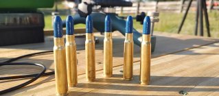

So here's the deal. Noticed I get some odd bullet holes semi regular like . And been having folks comment on it on my videos .Can't really figure it out because the holes on the paper will seem more ripped then punched but the holes on the cardboard box or whatever backer I put it on will be perfectly round . Only thing I can think is maybe the high humidity we had down here might be messing with the paper ? If the bullets where tumbling then the holes on the backer would be weird too and not perfect right ? so... o_O any ideas ?

While the target itself is probable cause I seem to remember the 8MM Mauser bullet diameter has two different sizes. Since we have no info on the rifle, barrel's land and groove specs, twist rate and if the bullets you are using match up to the barrel I don't think anyone here could add much more than the stated issues with your target's quality and how well it is stapled to the backer.

You will not see a difference on paper going from a .318 bullet to a .323 bullet.
With that out of the way, the cause is your paper that you are using. The paper has long strands in it that pull when being hit by a bullet. The cardboard is usually made of shorter fibers that were cut and processed more so they cut cleaner when hit by a bullet. The tightness of the paper also changes the shape, and since the cardboard doesn't move much, it also helps provide a nice clean hole.

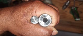

Slugged at .321 sized my bullets to .323
Irrelevant to the paper.

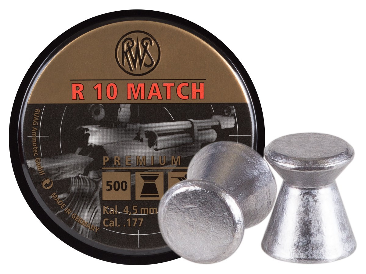

This is why bullseye shooters used wad cutters and 10m air and pistol shooters use wad cutters, cleaner hole in the paper if that is your end goal
