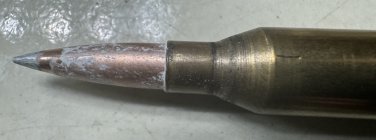

For me, I have hated the fact that necks compete with the application of HBN coating. In basic terms, the neck scrapes it all off when the bullet is seated, or at least a lot of it.
I have tried something new in what I consider to be the most accurate caliber at 600, the 6mm. I use coatings in .243’s because I’m certain now that what was considered a barrel burner, is not with HBN. But how to keep the neck from scraping it all off.
The bullets, all of the ones in shoot, will hold just about their own weight up, and only that, in a fired case, if not fall right through. On the other hand, I can take that fired case and rechamber it. The expanded neck is no impediment at all to the bolt closing. The only issue is that it won’t secure the bullet, and they can fall straight through. But if it does secure it through either neck or full length sizing, then now it scrapes off HBN.

There is a way, and I’m not sure exactly why it works, to make a slight donut. I have a die set for the .243 WSSM. Going just by feel, the FL die can be tweaked until it will run down the neck not touching the body, because it is much fatter, and bump a donut that perfectly holds a bullet, as the ram stops at full extension. I suppose a .243 die cannot do this because the shell holder will hit the die before any pressure is exerted there. Then I run that brass through a Redding body die. Did the WSSM size the neck so that bullets do not fall though? No, for some reason the necks remained loose enough that they don’t grip the bullet tightly and do not remove HBN. Maybe it’s just my die, or maybe WSSM necks are specified as thicker.

Looking at your loaded .243, don't you think that one bullet to the next, there is enough HBN left in the barrel to grease the skids for the amount that was scraped off in the seating?

To me, that bullet looks like it has enough HBN left on it to coat 50 more. I found that if I didn't "polish" the bullets by shaking / rolling them in a towel, thus leaving a lot of HBN on the surface, that seating force is high and that seating scrapes quite a bit of coating off the surface if the bullet.
I use moly rather than hBN, but I keep the coating intact by using a clean VLD chamfer - no burs. I use a Gracey trimmer with a Giraud blade on every firing, in part to insure that clean chamfer. I've pulled bullets on loaded rounds and proven to myself that the coating is intact.
