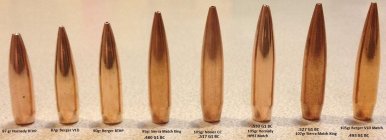

Check out the Picture... The line up of the bullets you asked about.
Enjoy
RT
