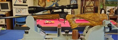

I've shot, the 120gr. NBT's to 500 Yards, from my, 21" T / C, single Shot, in 7 x 30 Waters and,.
It's pretty Accurate but for,.. 600 to 1,000 Yards, get yourself, a 6.5 Creed, .260 rem. .260 Ai, 6.5-284 or, or 6.5 PRC and,.. launch 140 ELD-M's, 142 SMK's or, 144 Hyb Bergers,.. as Your Wasting your TIME with, the 120 gr. NBT's,.. much past, 500 yds,. IMO.
If, using a 7MM go with, a High BC, 162 or, 168 gr Bullet, as Minimum, w/ 175 to, 184 grain Bullets,.. BETTER !
