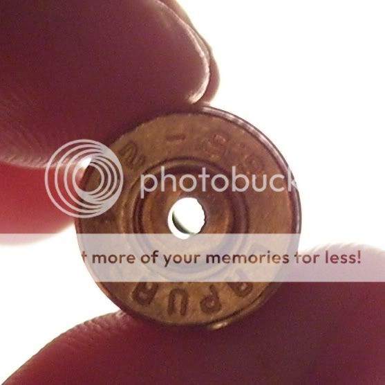

Are you sure that Lapua drills theirs? I recently bought 500 6.5x284 Lapua brass and the flash holes are not pretty. I also bought 500 Lapua 6br 2 years ago and they too have holes that looked to be punched. While out of the 200 pieces of Norma I own flash holes look great,2 diff. lots).Must say I'm alittle disapointed in my last purchase from Lapua because it wasn't cheap.

I believe that Lapua flash holes are punched, while Norma's are drilled. There was a thread on this a couple of years ago.
