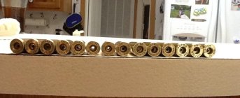

Here's a pic of one of about 15 pieces of Norma brass for 22-250 that has horrible neck wall thickness consistency I tossed em all in the trash. Measured with
Starret ball mic thin side .008 and other side .017!

I am very surprised as I have had excellent concentricity with the Norma brass I have used in five or six calibers.
Would love to hear their take on this...
This is my first experience with Norma I usually use lapua, I'm not sure
How old they are I got them in a mixed lot of once fired brass but if they are
Like this I be hesitant to buy new
I did a search for good 300 wm brass and lots of folks said they loved there old Lapua brass. Kinda Ironic cause Norma made the belted magnum brass for them! Can we see the head stamp? I only see one in the picture not 15!

Well Ray here's a pic of the head stamps not sure why you needed to see them?
These all have neck runout of at least .005 not bashing Norma but for the premium price it's not acceptable. The lapua brass I load for all my rifles is
always .001 or less not trying to sell anyone on lapua but it is what it is.

If you got them in a group of brass that was used,how do you know they were not culled out and used for hunting because they were not good enough for bench work.I am not slandering but the same thing happened to me. I bought a bag of 50 new cases from someone and they all were marked and none of them were all that great.
John that could be possible heck for all I know it could have been Norma factory
loaded ammo it's just my first experience with Norma brass and it shocked
Me to see that as all I hear is great things about Norma brass

I do agree with this to a degree but please explain how a poorly reamed chamber has the ability to change neck thickness consistency
Rem6br,
I have read that Norma has been getting good reviews lately with there thinner brass, my brass appears to be thinner then yours.
Ray,
I would definitely buy Norma brass and wouldn't think twice about. I would venture to say this brass is probably about 15 to 20 years old. Their quality
Control I'm sure is much better now. I guess I found something you don't normally see. I sure appreciate all your guys input on it for sure ;D
