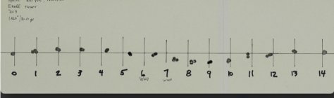

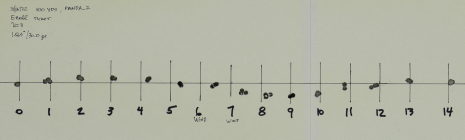

I've posted this pic before because of how apparent the sine wave pattern is. It's a tuner test but the same happens with powder charge and can also be seen with seating depth changes. The key, whether its with a tuner or by load changes is to systematically quantify group shape and size at small increments between all the way in tune to all the way out of tune. Frequency, in this application can be viewed as a measure of how far it is from the top or bottom of one nodal cycle to the next...ie, top to top or in the case of tuning a rifle, top to middle. Top being in tune and middle being the scatter node..or completely out of tune.
For all intents and purposes of this discussion, frequency is a constant. Even moving a tuner only has a small affect on frequency. Rather, it can change phase time pretty dramatically. What that means is basically by moving a tuner, we can shift the top of the sine wave left or right to coincide with bullet exit. Not trying to make this all about tuners but the principle is the same. Either way, we are optimizing the timing to where bullet exit happens when the bbl is at an anti-node, technically. An anti-node happens at top or bottom. A node is in the middle of a sine wave.
With my standard tuners, on a typical centerfire br contour barrel, there are only about 4-5 marks(only .004-.005" of tuner travel!) on the tuner between an anti-node and a node. This is important because knowing this allows you to break down relative tune to only 4-5 increments and can be interpreted by group shape and size. That's how you know what to do with the tuner and when, in terms of how far to move it. It also explains why so many people feel like the ocw method seems to work or at least get ya very close. Because you're never really far from in tune if you break it down to the distance between the node and anti-node of a single nodal cycle. I mentioned earlier that I had been able to do the same thing with a ppc and n133 powder. What I found is that 1 mark on my tuner is very near the equivalent to .3 gr of powder. There are too many variable for me to say the same about other powders and in different cartridges and that also part of why I can't agree with the previous statement regarding 3% powder increments across the board. But I say this to show that both methods work on the same principle and that yes, it can be quantified, the value of a mark on a tuner vs powder charge increments. Either methos is about timing bullet exit with optimal muzzle position.
Oops! Almost forgot to post the picture. I didn't shoot this test. It was fired by a customer but clearly shows the sine wave.

Just a follow up thought that I don’t know if it really matters being the top or the bottom of the wave because out of tune rifles shoot all directions.
Excellent shooting.
Excellent shooting.
I can't take the credit for that. As said, a customer shot this test target but a good short range br rifle, in good conditions, should shoot similarly to this test. It needs to be done only with flags and in really good conditions. Ultimately, the test is only a single 3 shot group at each tuner setting along the way. What makes it useable is that you should get predictable and repeatable results for a couple of groups on both sides of a sweet spot. As long as we get that, you're looking at about five groups rather than one, to determine if it's really a good and repeatable setting. Without flags, there's simply no good way to know why a shot comes out(or in) of a group. I like to see the groups open a little more than these did when it's out of tune. Barrel stiffness is a big factor in that. Bigger groups when out of tune are simply easier to read how well the gun is tuned..or not. Actually, this has prompted me to go to slightly smaller and/or longer contours than I use to use on most of my builds. To a point, I prefer a little less stiffness. I call it "talking to me." They'll show tune more apparently than a really stiff bbl. And fwiw, a fatter bbl is not necessarily stiffer overall. Length has more to do with stiffness than bbl od. In my short range stuff, I've settled on my own contour than is about .900 at 24" long. It's pretty close to a std LV contour, though.
