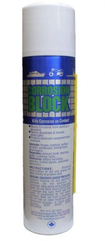

This is not the answer you asked for, but there are a number of commercial aerosol products that will protect carbon steel I horrible conditions. Even if not your final solution, maybe a stopgap measure.
